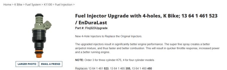

… Yeah, that last one is annoying. 22mpg on the last tank. This is a vast improvement over the 8mpg I got while the fuel pump and leaky regulator hose and misguided in-tank sealant application were conspiring to happily pump $6/gallon California gas out in a smelly flammable trail behind me everywhere I went, but I was really hoping for closer to 40mpg.
New injectors are on order… At this rate, the $3,000 F800ST I passed on as ‘too expensive’ in favor of this K75S is looking like a damn good deal, but I’m hopeful that I’m running out of things to fix.
