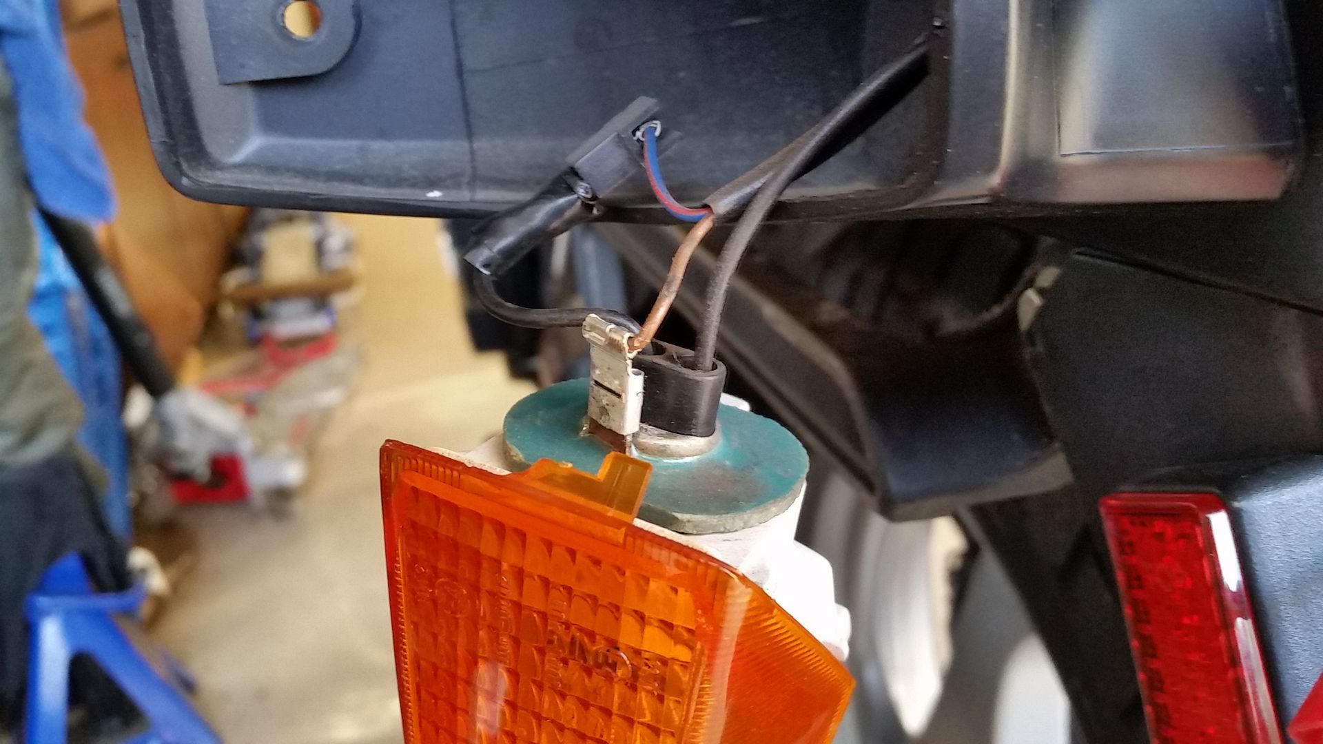

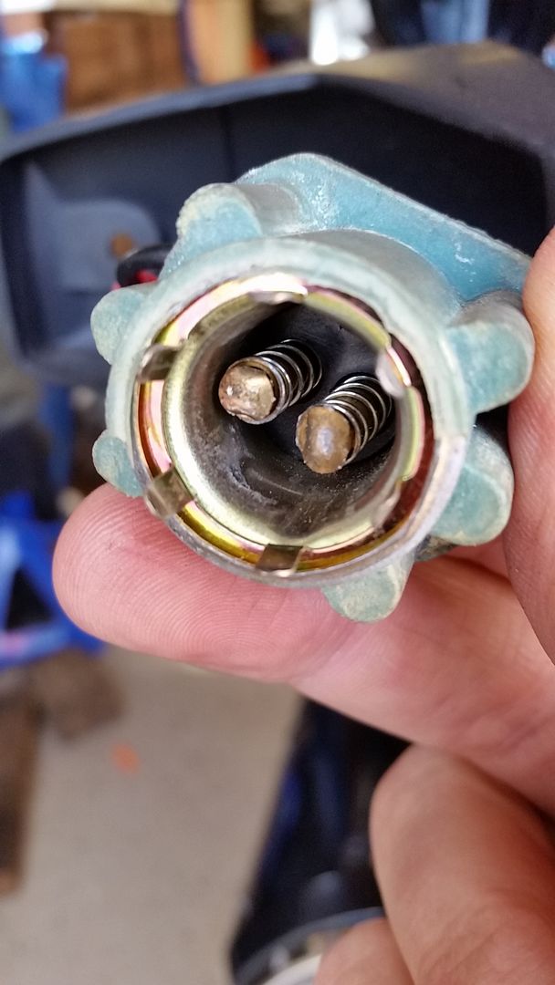

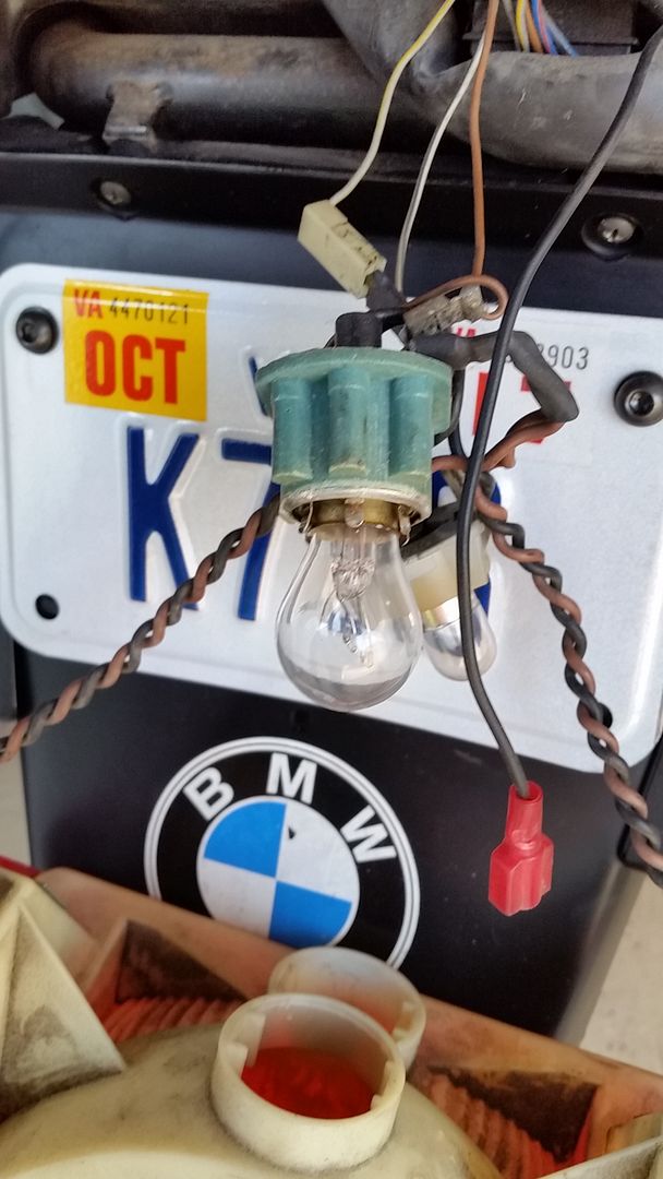

found that a PO had done an early upgrade to make the tail/brake light more visible.  they changed all the bulbs and sockets to use dual filament  1157 bulbs.  took me a few minutes to figure out the wiring and compare to shop manuals to see what was going on.  was this an aftermarket upgrade kit years ago?
not stock socket?
these were actually added lights in an unused part of the tail lens for the brakes.

thanks for the link!!!  the set up had to be something available.  looks like the same sockets had been installed in the turn signal housings with 1157 bulbs as part of kit from same company, but the one element of the bulb was not wired up (the red connectors in the first pic).  i suspect that is too much heat for those small housings to dissipate.

One of the issues with running lights on the rear(at least in the us) they must be RED. So an 1157 lamp in the standard turn signal lens will give you an orange running light situation. Unless you can find a red lamp. And yes, heat is also an issue with the rear lens assy's.
I seem to remember they made a running lights kit with LED's, as I bought 2 of them for my 1100's. There was a separate red led assy that you insert thru a new hole drilled into the turn signal lens housing.
