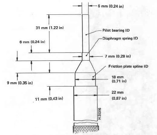

Re: How to line up the Clutch Disc when replacing the trans?
« Reply #4 on: August 04, 2015, 11:27:35 PM »
dimensioned drawing of the tool:

« Reply #5 on: August 05, 2015, 01:14:39 AM »
Thanks!   Not sure if I can whip one up, but it's amazing you could pull that drawing up so quick!  I may have to see if the local machine shop will do this at a reasonable cost. It certainly would make the job easier!

I was wondering what the holes in the pressure plate thin "links" were for. I bet thats where the official tool mounts, with a shaft in the center to fit the disc.
The picture that RBM posted is the official BMW tool.........
There are some 'centering tools' available on the internet for sale, but not all of them are made with correct tolerances. BTDT I got one and still had to turn down the 6mm nose end as it wasn't 6mm as required.

The one sold by a guy named Kenneth Lively is supposed to be machined to the spec posted by rbm. He also sells a replica of the BMW valve adjustment tool, which I've used. Google him if interested, I got both pretty cheap.
