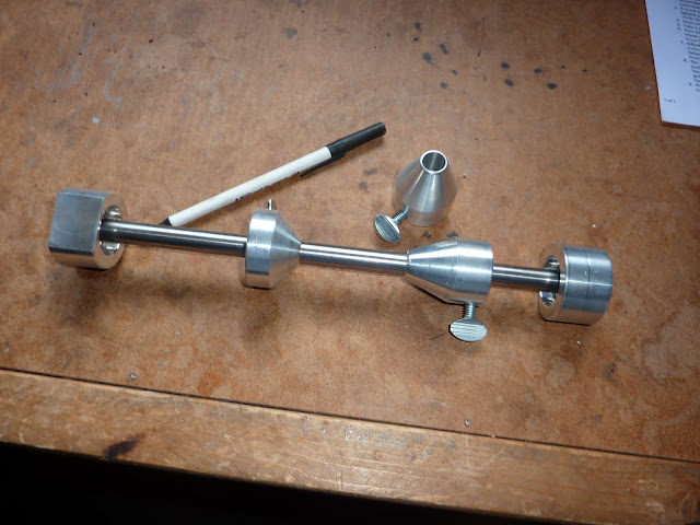

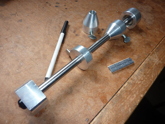

I just received my marc parnes static balancer the other day and balanced my Road Pilot 2 rear. Took about 5 minutes. It's a simple but well made precise unit and by the time I balance the 3 tires I need to do it will have paid for itself. Cost to do one bike was $105 shipped but I added a cone to do my wife's bike also which added $25. It is surprisingly small and I could not believe it was in the package that sat in my mailbox. I put a pen in this pic to give a size reference.
The black caps are to keep the bearings and cones from sliding off the 1/2 inch axle.
One side of the bearings is flat so it can be set up on any two equal height stands, saw horses, etc.

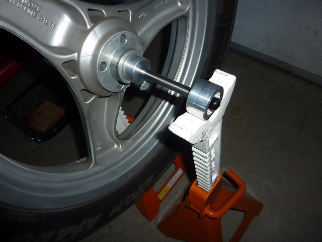

Here it is set up on my Chinese jack stands with the old LT wheel on it.
When I balanced the new tire on the RT wheel I got on EBay the heavy side was the valve stem so I added 3 weights (7 grams each) to the opposite side, tucked into the spoke. This was pretty good, probably as good as a shop would do, but not perfect. Since the weather is so crappy here, I had time to fiddle with it a little, and found that the third spoke was now the heaviest so I stuck one 7 gram weight to the opposite side. Perfection. The wheel could be put in any position now and there was NO movement. I was hoping to hide the weights inside the spoke but had to settle for one out on the wheel.
When I checked the wheel/tire that came off the bike it was 1/2 ounce off of being balanced but I don't know if that's because it was worn or not balanced correctly. It will be interesting to pull the wheel after about 5K and check it again. And if it is out of balance by then will rebalancing add miles to the tire?
Anyway, I no longer have to go to a motorcycle shop to get my wheels balanced and scratched. Just go to the local tire store and he mounts them, so far for free, and then balance them myself.
