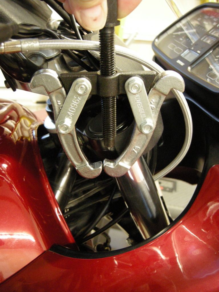

FORK OIL: I use Honda 10W red fork oil and change it annually. Here's a good write-up on identifying what forks you have and what amount of fork oil you should use in each side.
When draining the fork oil place some aluminum foil on the brake rotor and tire below the fork drain plug so you don't get them all messy when draining the forks.
Do not overtighten the fork drain plugs when putting them back in.  Just get them snug and be careful not to strip the threads.
To refill the forks I use a small kitchen funnel and measure the fork oil with a Pyrex measuring cup. (I'm not married.) Go SLOWLY as it takes time for the oil to find it's way in.

WRT filling the forks with oil, I recently changed fork springs from the OEM 20 year old originals to Wilbers Progressive and used a cheap puller to remove the snap ring and spring retainer. This made the job of refilling the forks super simple and fast.
93 K75S Mystic Red
IBA #9469
jsb
The altitude plug exists on the 93 K75s of all flavors. You may not have the actual plug, but you will (should) at least have the plug receptacle, under the set on the left side, tied to one of the frame rails.
I never have gotten around to getting one of the pullers for the fork oil, always just muscled it out. Have gotten pretty good at it that way. I guess I'm not terribly smart that way.
I notice you own both 93 and 94 K75s. Could you take a picture of your altitude plug/receptacle and post it here providing a reference location for me.
As for the fork oil replenishment, we all learn from eachother's experience from sources such as this website where K-bike stalwarts abound. I can say that with the internal fork spring pressure removed by the puller centre bolt putting pressure on the fillister head screw (fork oil filler point), the snap ring literally popped out with only a slight poke of a picking tool using only one hand; it was truly a wonderful experience.   :hehehe
