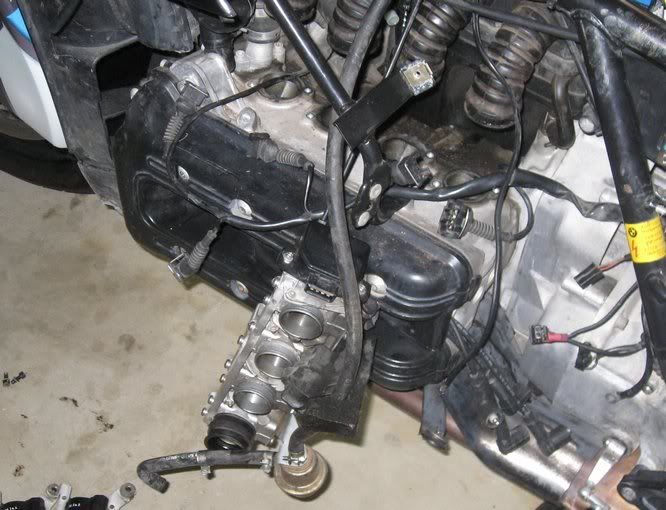

I moved my little pictorial of the intake manifold and fuel rail removal to K1100 Intake Manifold Rehab so it would be easier to find. I'll add to it when I put it all back together.
