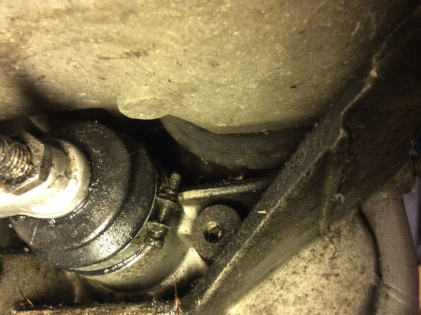

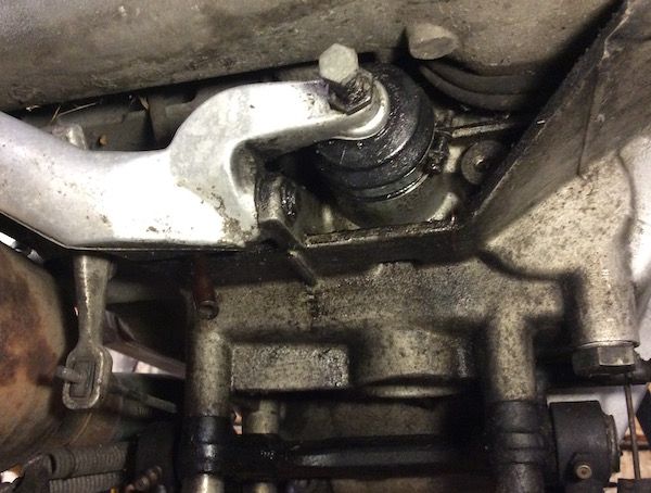

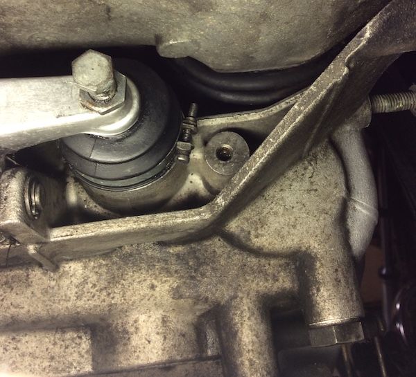

Hey guys,
Found some oil on the floor and after some investigation, did a search and found this article seems to agree w what I got going here.
http://www.motobrick.com/index.php/topic,2883.msg16783.html#msg16783
But please take a look at my pics and if you agree/disagree please let me know.
Plan to order new cup from bobsbmw.com at $45.35.
Please let me know if you have a better resource.  THANKS!

« Reply #1 on: October 08, 2016, 05:30:22 PM »
I would very, very carefully remove the boot and check it closely for splitting before I spent $44 on a new one.  But that's just me.

« Reply #3 on: October 08, 2016, 05:46:30 PM »
If it is split, I would give it a very good cleaning with a paint prep degreaser like PrepsAll and give the split a shot of super glue or possibly the stuff they use for sealing retrofit CV joint boots.

« Reply #8 on: October 08, 2016, 06:15:02 PM »
Also check that the clutch is correct adjusted.
If the arm have to much angle from where it should contact the sealing surface on the boot,
the spring inside the boot won't be able to add a even pressure all around in the boot...against the lever arm.

« Reply #14 on: October 08, 2016, 07:39:54 PM »
Got things as clean and dry as I could.  Bout a 1/2 a cup of mucky gravel and sand in there.
Couldnt find any obvious tear in the boot from this angle.
Tucked a couple white kleenex under the suspects.  Ill check back in the morning.
I checked and found clutch was out of adjustment, THANKS, Inge K! (78mm)
So I got it set at 74.6mm, re-set the rod push bolt at the lever and free play at the control. The boot now looks to fit a bit better.
Also lubed the barrel.
The oil smells of gear oil.  So apparently that is completely normal as there is no inner seal to prevent this.  Though there is an o-ring in there that could be bad.  Im not exactly clear what the o-ring does...maybe its what keeps the oil from traveling into the clutch disk?
Got things dried out again and gonna wait and see if the mis-adjusted clutch was the culprit. (deforming the spring and not applying even pressure around the boot OR the boot is just showing its age and needs replaced.)
I will report back later.
