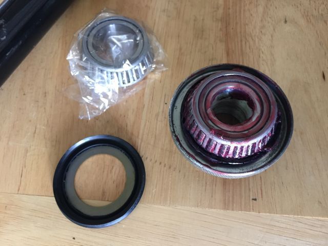

Very useful topic - and the link to the videos, which I watched a few times. This is my first time doing this job - and it was going slowly but smoothly.... till now.
I used All Balls bearings - got the races in the frame and just installed the top bearing on the nut. However, I used the dust seal that came with the All Balls kit. The seal has a rubber outer lip, which I thought seemed like a nice improvement over the OEM. But now it is very difficult to turn the bearing. Is this why it was recommended to not use it? Has anyone had a similar experience? Should I install as-is - or maybe get a new bearing and BMW dust seals for top and bottom? I have not installed the lower bearing yet - pending advice.
Edit: When I slip an old race over the bearing with the rubber dust seal it moves much more easily. Seems like it will work fine - but I am still curious why people say not to use the All Balls dust seals with the rubber.

Thanks for the reply. I went ahead last night and used the rubber seals that came with the All Balls bearings. Here's what I found:
When installing the bearing on the top nut (over the rubber seal) it was difficult to turn - it moved freely, but I could tell there was resistance due to the rubber. When I put an old race over the bearing it moved more easily.
I decided to try the lower bearing and seal - figuring I could remove it if needed. This one also offered a little resistance.
However - when I put the triple clamps back on the bike, they moved freely and effortlessly. The resistance from the rubber seal is inconsequential against the leverage of the triple clamps - and will be even less relevant against the leverage of the handlebars.
Conclusion - initially, the rubber seal seemed like it was going to cause a problem, but I think it may be an improvement over the OEM design. It seals the bearing, whereas the OEM design is more of a shield, which relies on grease filing the space between the bearing and the all-metal dust seal.
