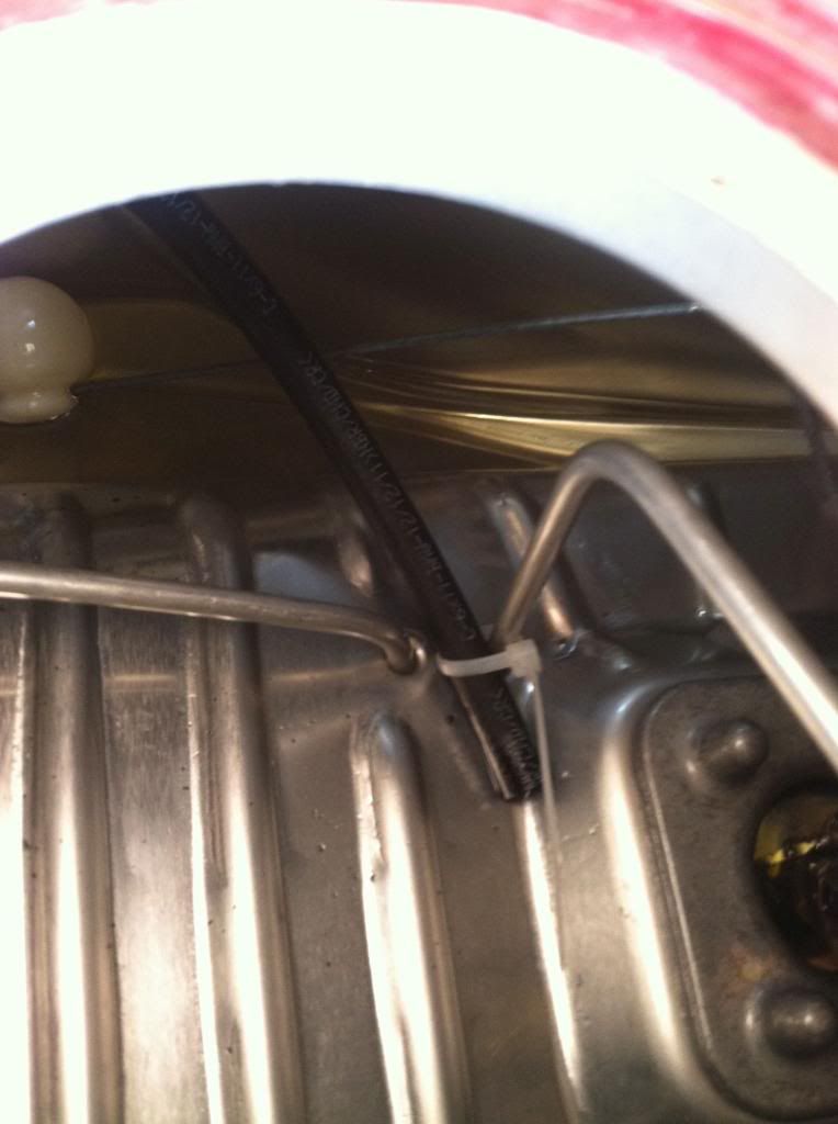

So I got ahold of some submersible gas hose, spent about an hour try to bend the shed biscuit nipple to get some traction on it, and nearly wrenched my hand off (I have big hands) trying to slip the too-small hose on the nipple (which, by the way, is not meant to have a hose on it). Finally was able to slip a hose clamp over the connection, and now the return fuel line drains down at the bottom of the tank instead of right next to the return spray.
The whole thing took a couple of hours and $10 in dealer-supplied parts (hose). I'm looking forward to a blistering hot day tomorrow to test it.
Added: here's a photo of the gas line in the tank:
Thanks for the help everyone.
