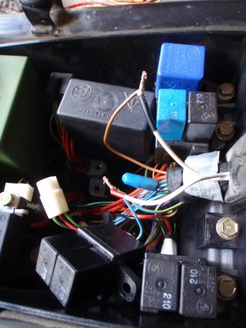

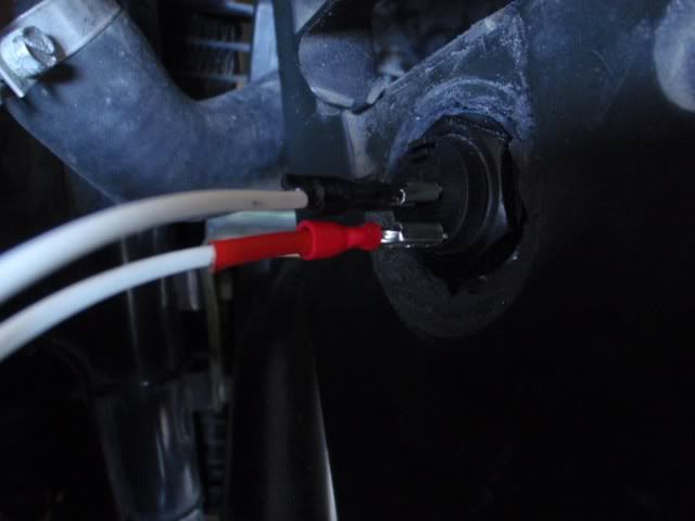

« Reply #13 on: October 09, 2012, 08:35:57 PM »
Any insights for a noob?
I thought I had this dicked.  Not so much.  :beatdeadhorse:
So far here's what I 've done:
Installed new fan motor and tested by powering direct from battery- pulling as it should
Added manual fan switch according to Lieberry instructions.
Can someone look at these photos and tell me what's going on?
cut L/Y under relay and pigtailed wire to open pole of switch
cut Br off of alarm harness and pigtailed "grounding" leg to other pole of switch.
Am I correct to think the alarm harness should provide a good ground?
Fan motor is connected via stock wiring harness now.  Reading 12V at the connector.
When I power up the FAN STAYS ON ALL THE TIME.
When I jump out the fan motor brown wire to the to the negative battery terminal, the fan stays off on power up.  The switch still doesn't work.
Is this telling me the brown to the fan motor in the harness is no good?  It crimps together with like 20 other wires, but I have no other electrical issues at this time.

Re: Fan stays on all the time...K1004V
« Reply #14 on: October 09, 2012, 08:59:52 PM »
If you cut (instead of tapping into) the blue/yellow wire then you should not have 12V to the yellow/violet wire - unless the relay is stuck closed.
« Reply #16 on: October 09, 2012, 10:02:37 PM »
Sorry but "pigtailed" can different things to different people.
That last pic lets me know that you did tap into the Blu/Yel wire.
If the fan is still coming on then there's one of four causes (in order of what I think the probable cause is):
1) Your temp sensor is failing.
2) The wiring from the temp sensor wiring has chafed and is grounding, telling the Moronic that the engine is very hot.
3) The Moronic has failed and grounds the Blu/Yel wire when it shouldn't.
4) Your fan relay is stuck in the closed position.
I'd troubleshoot #4 first though because its easiest.  Disconnect it from the Blu/Yel that comes into it and see if the fan runs or not.
