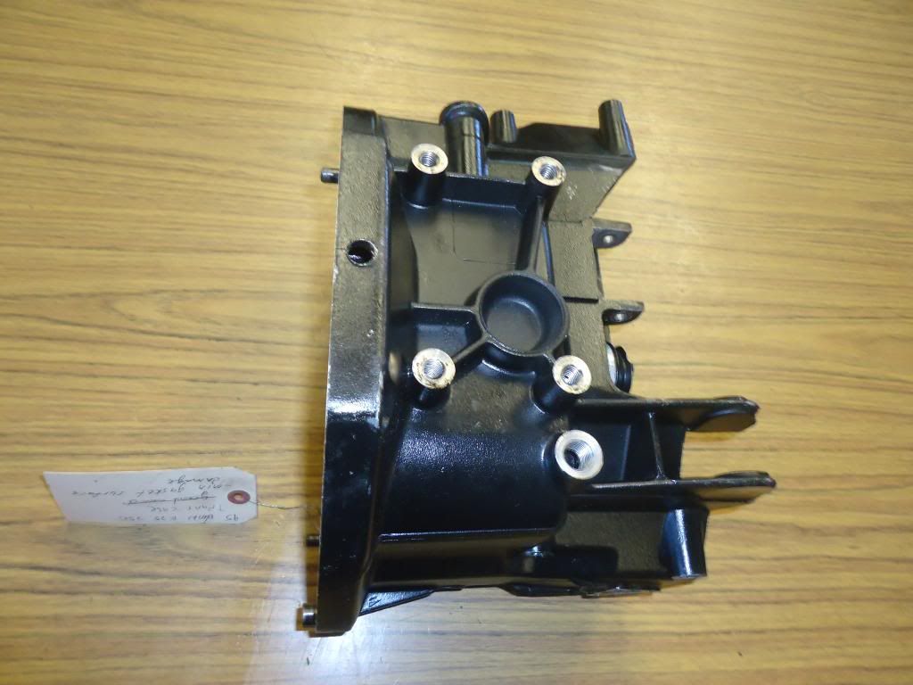

My understanding is that the K75 transmission casing has the paralever strut tangs moulded into it but are unused,  similar to this photo:
I understood this from following the build thread at http://k75projeckt.wordpress.com/ and, from here, I come to realize that it is possible to install a paralever swingarm and final drive on a standard K75 transmission.  Are these paralever strut tangs available on all model year K75's or just certain model years?
I believe there are gearing implications by taking this decision, as you described above.
Regards, Robert.
Yes, Larry "Special K" did a K75 by drilling them on a K75 he did several years ago.
Some of the early transmissions don't have those tangs.  Not sure year/model-wise.

My 92 K75 has them.
