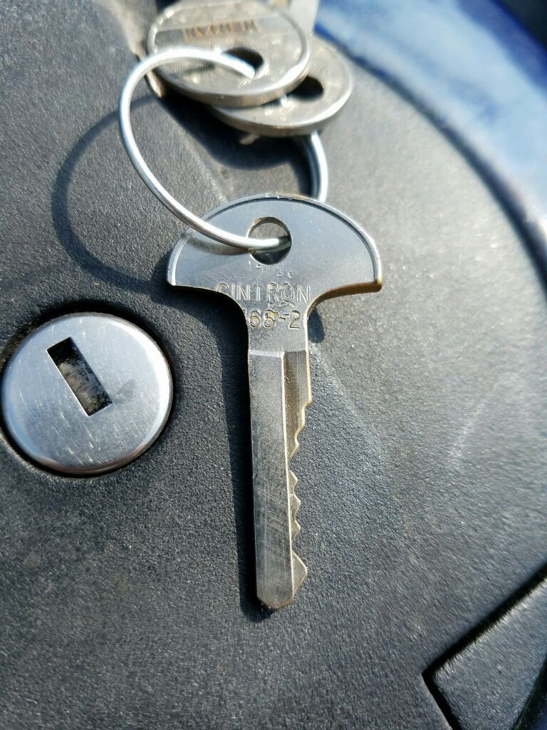

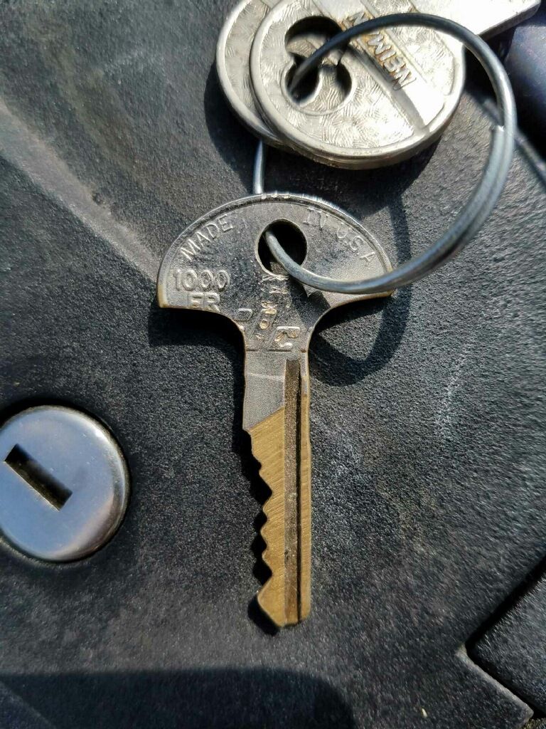

Re: Where to get blank ignition keys cut/copied?
« Reply #21 on: June 12, 2016, 12:20:07 PM »
I had a key cut at a locksmith a couple of months ago. It took him a while to find the correct key blank to use, but he did. Works great. Ilco X109 FT43
