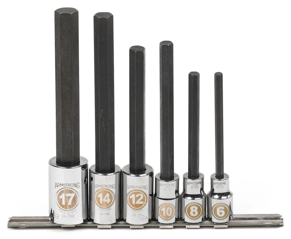

I stopped here.
It's a 5mm hex head. The plain allen fits it snuggly but I can't turn
it. The one seen here says it's a 5mm but fits it so loosly I fear
I'll strip the head.
(feels a 1/2 size too small)

So there's this hex head bolt secured with locktite deep in the case. (see last pic) A standard 5mm allen (Craftsman) fits very well, but lacks enough ass to loosen it.
A long T-handle 5 mm (Shades) reaches it well, but is so sloppy I feel like it's going to round off in the bolt.
Another T-handle 5mm (Husky) fits snuggly but is short.
I keep thinking.'what the hell, they're all marked 5mm but the ONE I want to use that is long enough just does not fit.
I check them.
*Chraftsman*
*Shades*
*Husky*
Well, Damn! That's strange...or is it? :dunno
I check them.
All Allen wrench's wear slightly from use, especially your fav T handle.
Is there room for a Allen socket with an extension bar for a ratchet or T handle for length access ?  How about a longer length Allen socket instead ?
