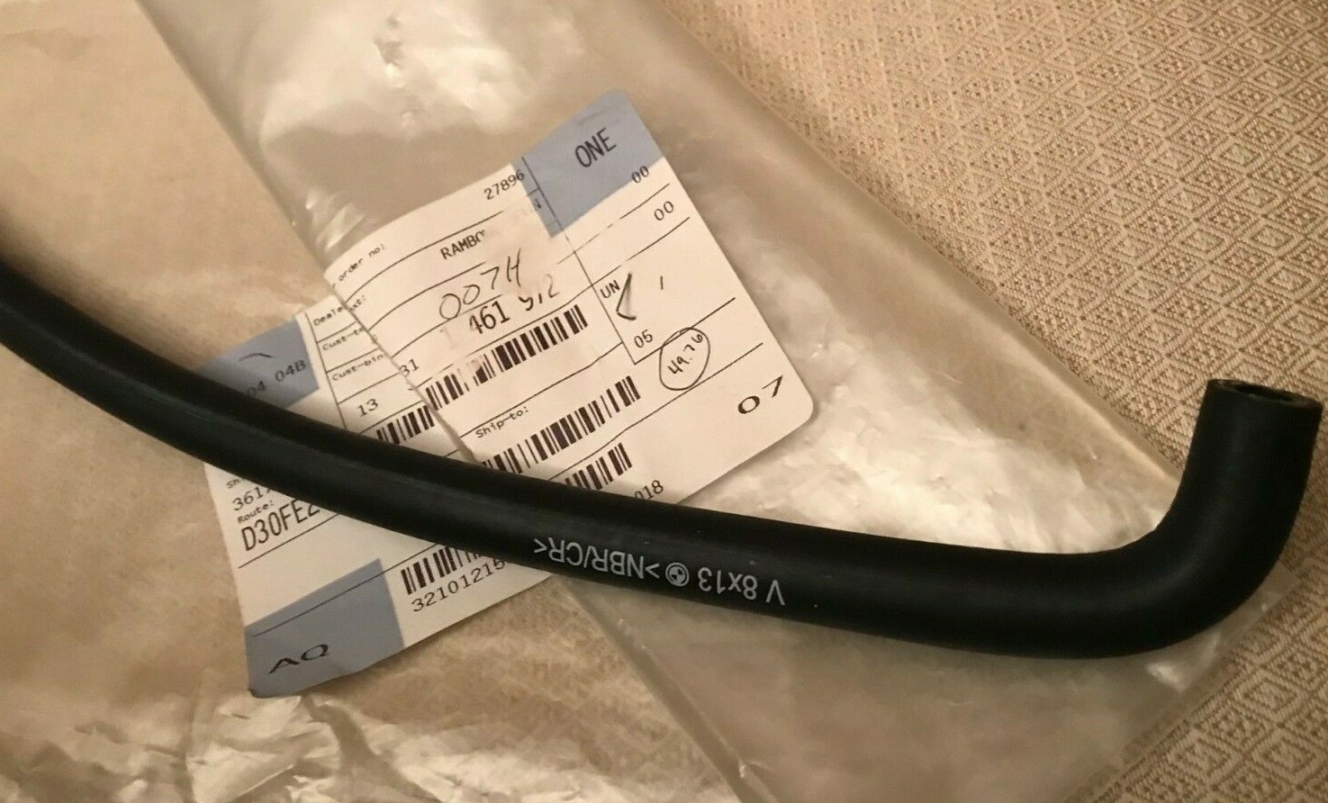

Does anybody know the part number for this air box hose? I can't seem to locate it on Max BMW's website, mine is old and cracked.

 31 1 461 972    HOSE   0.13    1     $48.58

Thanks Mike, I did find an ebay auction for one, I just don't see how it is the same hose (at least in your picture), here is the picture from the auction: don't see how it is going to bend in the two places.
Here is another picture of how it has to go on.....do you think the hose above will fit?

 Paul, I do recall that I had a problem matching up the hose for a 1993. I believe that there was a mid-year change for a short run and the dealer kept getting the wrong one. The correct one was much cheaper.

Actually, I know it is confusing but I think the part you need is this one = if you look in the Max BMW fiche is appears in engine block mounting parts section not the airbox section as you might expect.
10
11 15 1 461 835 VENT HOSE
0.11
$48.39
Part Thumbnail
[/t][/color]
The part MW posted is actually a fuel hose I think, if you look at the fuel injection system part if the fiche the same part number appears there as well.
10
0.11
$48.39
Part Thumbnail
[/t][/color]
You are correct! Put that number in ebay, and came up with the correct hose, thanks!
