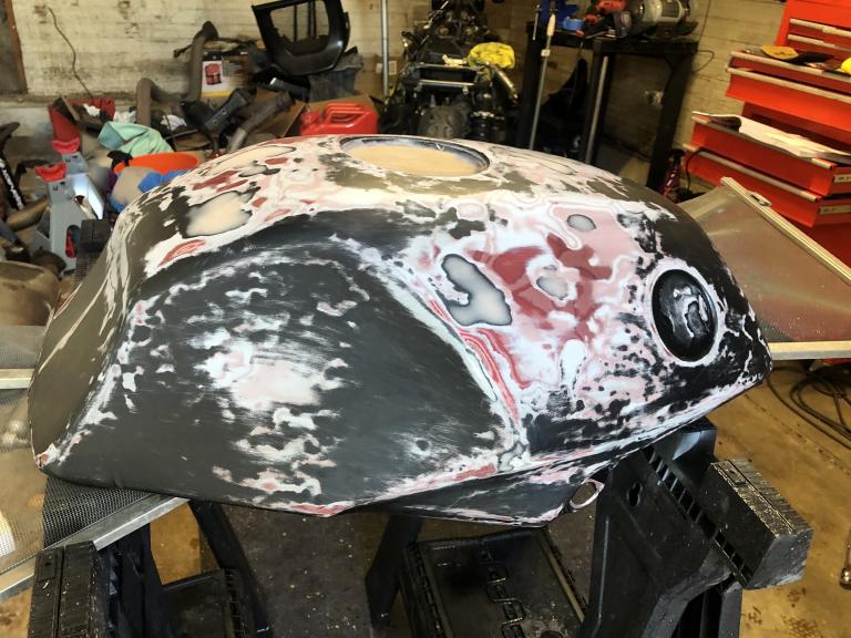

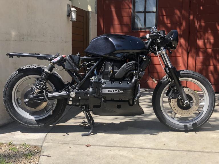

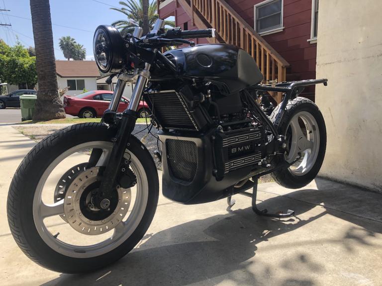

It's been quite a long road of trial and error.
Finally got a triple tree clamp created that will house my Motogadget Mini
Still on the way, custom short rear sets and really nice seat: https://bit.ly/2GyHziu
So far i've done the following:
- ABS Delete
- Custom SS front brake line
- Rewired the entire bike
- Fitting 7" headlight
- Custom throttle
- Lowering forks to accommodate my riding style
- Engine Tune (plugs, wires, timing)
- Land Rover Metallic Black on the gas tank
(will paint seat and lower faring same color... may do bedliner on the bottom of the faring as it's going to get some debris from rides)
- Ducati Monster 821 Hand Controls and Brake Master Cylinder
- LED Signals
- LED Circuit board bypass
- Rebuilt fuel tank (filter, pump, fuel level sensor, cleaning)
* IMG_9482 3.JPG (97.85 kB . 768x576 - viewed 2940 times)
* IMG_9486 2.JPG (87.4 kB . 768x576 - viewed 2819 times)
* E00BD357-B947-44C5-981B-0EA8D2649451.JPG (24.07 kB . 324x576 - viewed 2798 times)
* IMG_9497.JPG (74.7 kB . 768x576 - viewed 2850 times)
* IMG_9501.JPG (73.71 kB . 768x576 - viewed 2832 times)
* IMG_9502.JPG (84.89 kB . 768x576 - viewed 2871 times)

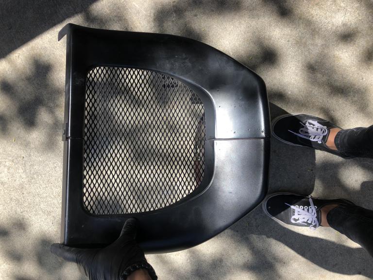

Still to come and looking for any suggestions:
- Deleting separating line in the bottom faring so it looks like one piece
- Muffler
- Painting forks
- Painting kickstand / Center Stand
- Shaft lube
- Tires
- Brakes
- Seat fitment
- Overflow tank relocation
- Lithium Batter Relocation (under seat)
- ECU relocation
- Ignition switch relocation
- First Ride :)
Really happy with my progress in between huge film projects and working on my Land Rovers.
Can't wait to get it out put some hours on the bike.
Getting close!

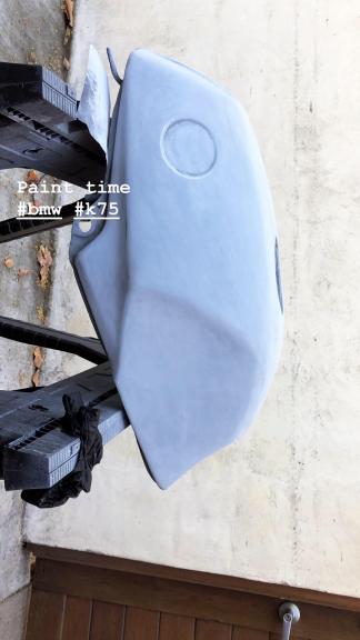

« Reply #8 on: April 22, 2019, 05:27:20 PM »
Now just wait for my paint delivery.
Fiberglassing the inside for more rigidity and taking care of some stress fractures.
* E0B39EE8-6859-4545-91CA-848B1DB07E26.jpeg (72.93 kB . 768x576 - viewed 2808 times)
  • Los Angeles
  • 1991 K75s

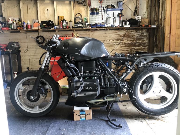

« Reply #9 on: May 31, 2019, 02:12:38 AM »
Quick update:
Bike is coming a long way, had to take some time down to work on one of my land rovers, but finally got to wrench on the bike today for a bit.
* k75s_May_30_19.jpg (75.8 kB . 768x576 - viewed 2884 times)
Up next:
- Revise new mount for 7" headlight
- Install Motogadget motoscope mini
- ECU mounting options
- Tires (Thinking Pirelli Angle GT2)
- Brakes
- Spline Lube
- Oil Change
- Exhaust
- Paint
- Wheel powder coating
- Seat Upholstery
- Front and rear signals
- Maiden Voyage
  • Los Angeles
  • 1991 K75s

I really like the belly pan, is that an original K100 RS belly pan?
I also like your exhaust but would worry about how loud it is, is there any silencing built in?
Cheers
  • Houston Texas
  • 1993 K1100RS
Offline almostordinary
  • Posts: 76
Re: K75 - Starbucks Warrior build
« Reply #22 on: August 19, 2019, 11:31:45 AM »
Thanks! It’s the stock k75s belly pan. Really accentuates the lines.
The exhaust is a bit loud when the choke is open but quiet enough when the bike is warm.
Haven’t taken it out yet to see if it’s too loud, but there is some silencing built in. Not a ton though.
Hoping to get her out by weeks end and put some miles on the bike
