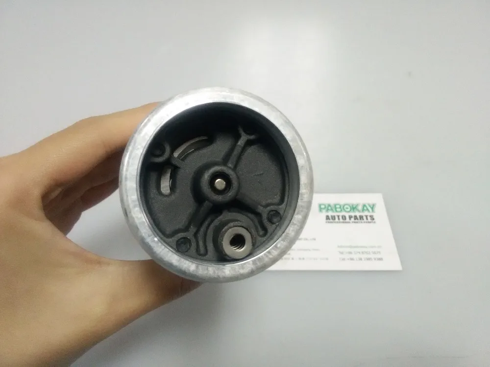

For what it is worth, the bottom of my fuel pumps are each exactly the same (oem and cheap replacement), as seen in the photo on the right previously posted. I won't bother to post another pic as it is the same.

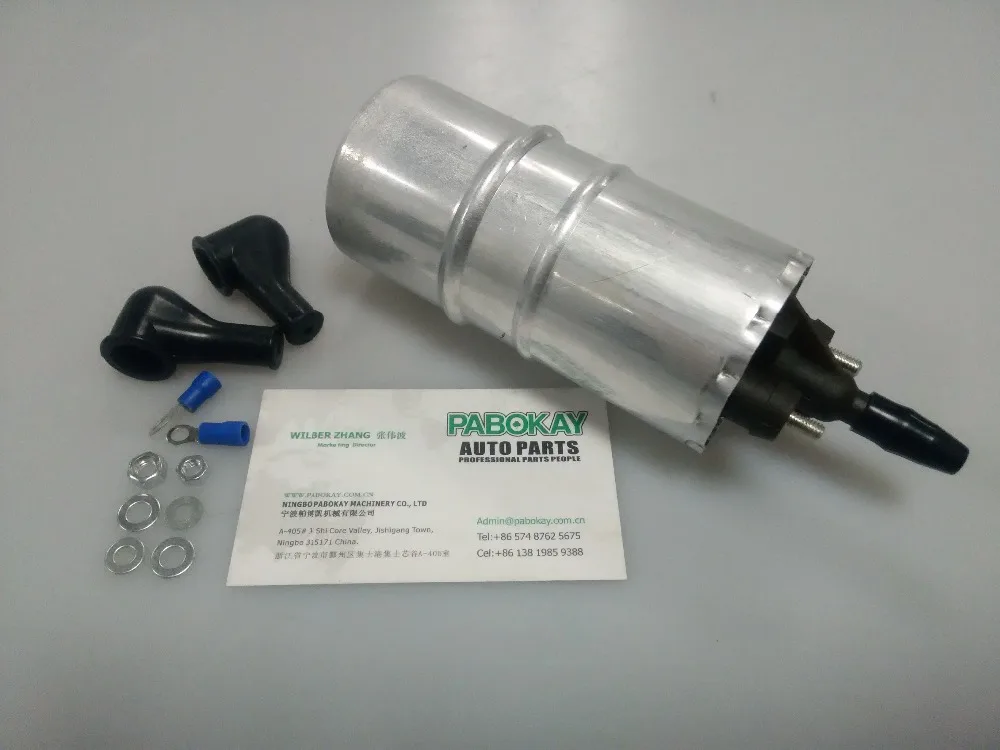

I too ordered mine from AliExpress.  A vendor named PABOKAYAUTOPARTSFLAGSHIP Store
https://www.aliexpress.com/item-img/16121461576-16121460452-0580-463-999-0580463999-52mm-motorcycle-fuel-pump-for-BMW-K75-K100-K1100-K1/32749689991.html
From the obsessively compulsive searching I did, Aliexpress seems to be the cheapest option by far, albeit with the trade off of taking appx. 10 days to ship.  I paid $25 U.S. including shipping.
]52mm motorcycle fuel pump for BMW K75 K100 K1100 K1 1983-1997 16121461576 16121460452 0580 463 999 0580463999
