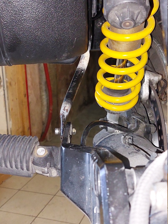

A little improve of my K75GS: the OEM K1100LT shock was perfect for it, but I noticed that it was sometimes not stiff enough on big potholes when the bike was fully equiped. So I bought a used Ohlins shock for a K1, intending to fit it on the K75GS.
Two problems appeared:
- the soft line to the compression setting cracked and leaked. So the shock was rebuilt at a specialist nearby, and I got the spring resprayed.
- there's not enough room between the bottom of the shock and the brake caliper.
I thought it was easily solved by rotating the drive cover. But the holes are not symetrical, no position fits. The solution is to weld another fitting for moving the caliper back. I cut an old K100 cover to get the new fitting welded:
The rear original fitting becomes the front fitting.
I asked many professional welders, but most of them refused to take the job as soon as they hear the magic word "brake": No, I won't take any responsability about brakes. Sad.
Eventually, I found a good welder who accepted. And made a very good weld. No finition required, nothing is too thick, it fits perfect.
I had to cut the breather that, now, is in the front of the caliper.
And my K75GS has now a beautiful and very efficient Ohlins shock. :cheers:
The compression setting device is hidden behind the battery, protected but reachable.
The preload setting is just at the front of the shock.

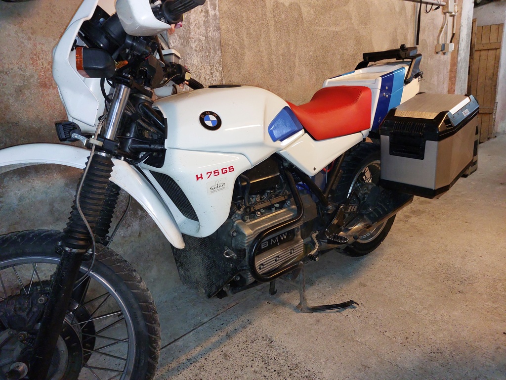

The K75GS had some minor evolutions this summer.
Minor but useful, as I'm due to travel now with an air pump to cure sleep apnea, I modified it to a single seat with a  police lid box behind, where I can put this stuff and a second battery to power it.
With a good service this summer, including new fork legs and a new fan engine, I had some short trips in the southern Alps.
I also adapted a case holder from Hepco Becker, made of solid steel tube, to carry large (huge) aluminium cases, more solid than the OEM Touring side cases and that could become a stool or a table when at camp.
I will soon have another improve...I'll tell you!
