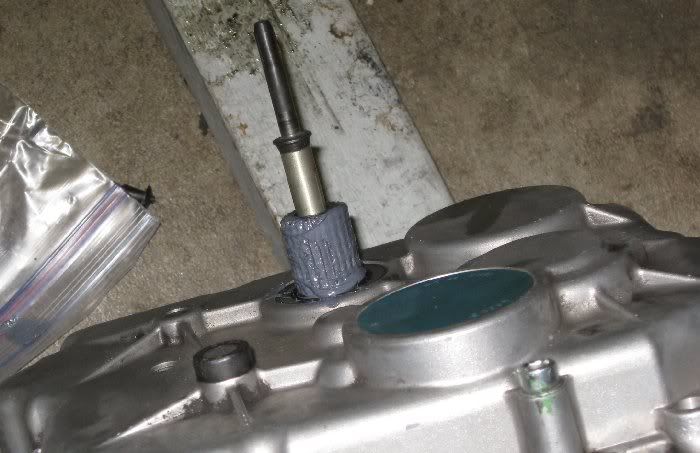

It this picture below I used Mobil 1 synthetic bearing grease for demonstration purposes only because it's red and more visible in the picture. It's a clutch plate assembly pushed onto transmission input splines.  The very fact that you can see that excess lube from the side demonstrates that it is well behind the rear clutch plate friction surface and will just spin off onto the bellhousing.
And here's how much of the Honda/Wurth 50/50 lube that I used when assembling my K75F:
Finally, if you pull your bike apart and the splines appear to be rusty then don't be alarmed. It's probably just the old red spline grease that BMW used to use.

http://www.ibmwr.org/ktech.shtml
I used a combination of the two articles in there, the Haynes manual and Duck's writings on my recent clutch spline lube project.
I bought a clutch alignment tool ($18.50 shipped) from Kenneth Lively aka polepenhollow@yahoo.com which I found helpful.
If you don't take the clutch apart, however, you won't need the alignment tool.
On mine, I had a leaky o-ring and/or rear main seal, so that required disassembly of the clutch too.

So Dr. D - My wife just ordered the Haynes 2valve manual. (I would have preferred the Clymer actually, but so it goes). Are there other write-ups online somewhere that have step-by-step instructions on removing driveshaft, transmission and clutch?
Just askin'.
Your wife is gonna lube your splines?  (Lucky bastard - even without the double entendre. :laugh)
Take a look a my ABS II spline lube post in The Lieberry.  It's pretty much the same thing but without having to F with the ABS and paralever.

So Dr. D - How long does it take you to perform a splienectomy on a K75? Figger I'll prolly need to double that for my 1st time at it.
Non-ABS K75:  About four hours if I had to do one quickly.  I usually take more time though and clean/degrunge everything while I have it off and relube the clutch arm pivot too.
Have lots of beer handy.  Running out can really slow things down.....
