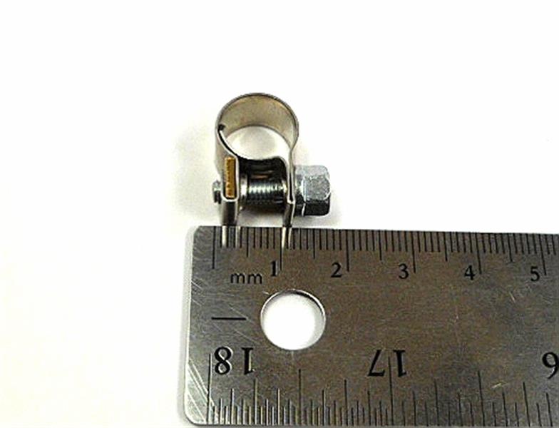

Is there any way to remove the BMW crimp on hose clamps without destroying hoses? How does one loosen them to get over the nipple?
I see many hex bolts with a dab of green paint. Is that from the dealer from previous work or maybe it has anti-seize?
Those clamps are called Oetiker clamps. They are considered one-time use only. I used side cutters on the pinched tab to cut them loose and didn't damage the hose to which they were attached. I replaced mine with lined nut-and-bolt style but lined worm-drive clamps will work, and many just use plain old hose clamps. The drawback with common perforated clamps is their perforations might damage hoses but you shouldn't be tightening those clamps  with a vein-popping strain anyway. :laughing4-giggles:
The green paint might have been part of a St. Patrick's Day motif but more likely it was somebody's way of keeping track of something. We'll never know. My moto has no green dabs.

Oetiker clamp are usually 1 and done use. You may try using needlenose pliers, O-ring remover, a pick or scriber to loosen but its difficult.
A sharp pair of cutters is best for removal
BMW recommended oetiker clamp replacement  17111460862
